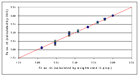

The present studies were performed on pure iron oxides: hematite [formal average Fe oxidation state of +3.00], magnetite [+2.67], and wüstite [+2.11]. Magnetite-wüstite and magnetite-hematite mixtures were prepared to give materials with average Fe oxidation states of 2.24, 2.42, 2.54, 2.80, and 2.89. The measured XAS spectra were normalized by fitting the pre-edge and post-edge regions with first and third order polynomials respectively. The average Fe oxidation states of the mixtures were calculated from the normalized, background corrected spectra by curve fitting with linear combinations of spectra from the pure components (open circles) and by interpolating to find the energy at which the edge amplitude reached 0.25 (closed circles). The agreement between measured and expected iron oxidation states was within ±0.04 and ±0.02 for the two methods, respectively. The extension of the technique to mixed valence iron oxide catalyst precursors is straightforward.
